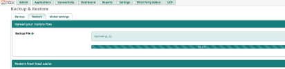

Messing around with this for Raspberry Pi, and the backup has been stuck this way for an hour.
I am not seeing much in the way of CPU usage, or out of memory.
Seems the file is quite larger than what the setting in php.ini was allowing, but after that change, still sticks at the same place.
Edit: I just ended up uploading it via SFTP. Still would like to know what possible what could be going on with that,

Maybe I was not clear, but I was uploading to RESTORE a BACKUP.
