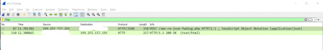

I've just finished testing the php script shown below. It works quite well. It basically takes an incoming sms message and sends it out to a forwarding number.
There are some limitations that you should be aware of:
1) It only works on BulkVS DIDs which are SMS enabled.
2) The forwarded message shows the original target phone number as BulkVS doesn't allow spoofing the original source sms phone number during the re-transmission.
This is a significant annoyance if the forwarded SMS needs to be replied to with the intention of reaching the original sender, but not so much of a problem if it's mostly used for two factor authentication codes etc. which do not require a reply.

To make this work on your PBX you simply need to put the above script in a text file under /var/www/html that you could name sms-rx-json-fwding.php assuming that you already have curl and php5-curl installed and enabled. Obviously you would need to enter the proper values for XXXXXXXXXXXXXXXXXXXXXXXXXXXXXXXXX, YYYYYYYYYYYYYYYYYYYYYYYYYYYYYYYYY and <YOUR_11_DIGIT_PHONE_NUMBER_FOR_FORWARDING_HERE>.
Then you need to configure your BulkVS DID which needs to be forwarded to the 11 digit phone number entered in the script. For that you would login into your BulkVS panel and go to Messaging > Message Webhooks. There, you can create a new hook in which you will use a URL like http://<yourPBXserver.com>/sms-rx-json-fwding.php assuming that you called your script file as suggested earlier. (You should also adjust your server name, adjust the TCP port number if it's different from 80, use https instead of http if you're using SSL on your server, etc.)
Oh! also, at that stage make sure that Delivery Receipt for that particular webhook is set to False.
Finally you would go to Inbound > DIDs - Manage and pick the DID that you want to configure, and set its Messaging Webhook value to the entry that you've just created in the previous step.
The php script gets triggered every time a message is sent via the URL defined in the webhook. So there is no need to run a periodic process starter like cron etc.
Please note that the forwarded message will include the original source phone number (Fr), the original target phone number (To) and the forwarding phone number (Fw) so that there is no doubt about the whereabouts of the message.

@Halea, thanks for sharing the SMS scripts - quite useful.
I'm successfully using the SMS forward to email one. However the SMS forward to phone number stops after this stage:
The PBX is fully functional and runs on Debian 10 based on the official install document.
My observation is that the statements:
sudo apt-get install php5-curl
sudo php5enmod curl
do not work on Debian 10. However, these ones do:
sudo apt-get install php5.6-curl
sudo phpenmod curl
...and as I said the SMS forward to email works just fine (based on the same requirements.)
Any suggestion where to start troubleshooting why the forward to number part doesn't work?
@sortons : Yes indeed on Debian 10 and Ubuntu 20.04 the package used is php5.6-curl and to enable the curl php module you have to run phpenmod curl. The script borrowed code from my earlier scripts which was based on earlier php versions on older Debian and Ubuntu OS. But actually any version of php curl support would work as we are truly using plain vanilla base functionality here. Same for module enablement command. I actually test on an Ubuntu 20.04 server and I was able to use php5, 7 and 8 for the same.
