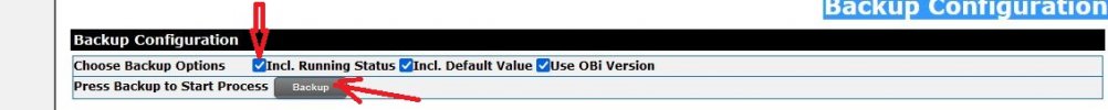

Just first get an IP address log into your GUI http://obi-IP-address (where admin:admin is the defaultuser:password ).
Then the first thing is to save your obitalk config
System Management / Device Update / scroll to Backup Configuration
Select "Incl.Running Status" as a minimum. Optionally incl Defaults, omit the use obi version, until you get a handle on the abbreviations.
Next click on 'Backup' button and save the XML file backup9CADEFB55555.xml where '9CADEFB55555' is your actual MAC number.

From the web UI Make and save a backup before undertaking changes
System Management/device update/Backup Configuration [Extract] button to start.
Obitalk does have a habit of loading the new config to the phone. If you quit Obitalk setup they remove their config; so always make sure of your current backup status.
