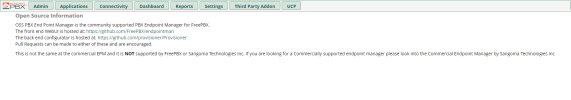

NEW OSS EPM for FreePBX 16 & iPBX 2027
Ah, but the commercial modules will not run on the raspberry pi platform. I specifically tried using the commercial Endpoint Manager and it would not run. It needs ionCube to decrypt the PHP before it can run. I tried installing ionCube but it requires setting zend_extensions in PHP.ini and something else is already using it. I stopped looking at that point.
I was more pointing out there wasn't a specific provisioning module for Sangoma phones.
Correct. So that is why I thought it might work to add a Brand and some templates to the OSS EPM for the Sangoma phones.
Should work just fine. There will be features on the phone that can't be used due to the lack of the commercial modules but outside of that, basics should work just fine.
You should wait a bit, after many years of failed cajoling, Sangoma have now been forced to go with Debian (of which and just in MHO, VERY pre-alpha ) which should fix all that nonnsense.
I setup the OSS EPM and got it working ok with t*f*t*p more or less with local phones.
I need to make it work via http or http(s) for external phones. Setting the provisioning url - https://"mypbxpublicip"/p.php/ I can see the phones connect in the /access.log but the phones do not provision.
The URI comming in is https://"mypbxpublicip"/p.php/0000000000.boot (its a yealink phone)
can OSS do public side provisioning? looking at the code for p.php it feels like this is not really ready.
