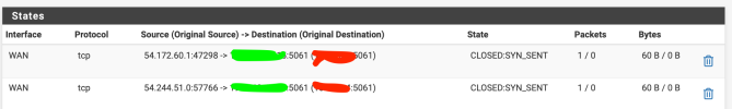

I am trying to use a cloud SIP from Twilio. I configured my Twilio account and PBX to communicate and establish SIP connection to my Twilio number. I am able to place encrypted Outbound calls. However, inbound calls are failing. I narrowed it down to the PBX not responding to the Twilio account when a call comes in. Both my twilio debug logs and my pfSense point that the issue is PBX not responding. Check the attached image.
Again, inbounds work great with my ATA which exists under the same lan as my PBX. Any ideas as to why the PBX is rejecting the connection? Something else to add is that the incoming call does not register anything on the Asterisk Log section of the PBX at all.
