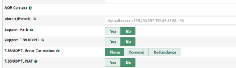

The Asterisk SIP settings have the correct External IP and local networks added. I've added the IP's of all of the BulkVS servers to the firewall with add-ip. In the local gateway/router, I've port-forwarded the SIP ports and RTP ports for the BulkVS servers, and RTP ports from any IP to the IncrediblePBX server. The gateway/router logs show nothing from BulkVS being blocked. All BulkVS server IP addresses are entered in the trunk's Match-Permit field. Our ISP has issued us a fixed IP address.
