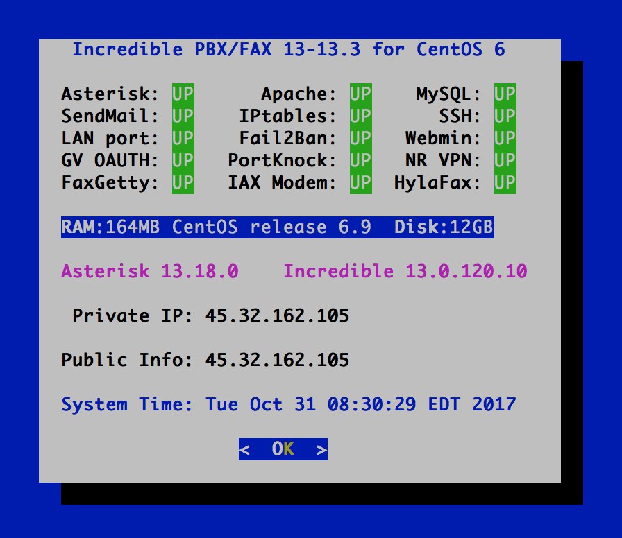

Happy Halloween. All systems go with latest Asterisk 13 release. Smooth sailing today on Vultr with 512MB Miami build and WootHosting with 1GB build in NYC...
Today's Tip: Did you know you can display your primary phone number in the pbxstatus dialog?
echo " 800-555-1212" > /etc/pbx/.phone
pbxstatus
