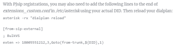

In the https://nerdvittles.com/another-bargain-sip-provider-for-incredible-pbx-platforms/, it says
A. Do I put my DID like 15148888888 as following?
[from-sip-external]
; BulkVS
exten => 18005551212,3,Goto(from-trunk,${15148888888},1)
B. Or 15148888888 should be replacing the "18005551212" as:
[from-sip-external]
; BulkVS
exten => 15148888888,3,Goto(from-trunk,${DID},1)
1. not sure which syntax is it ? A or B?
2. what are those lines for?
Why in the world is sip-external being used for this? Nothing should hit that will properly configured trunks. It should never be used for real routing.
