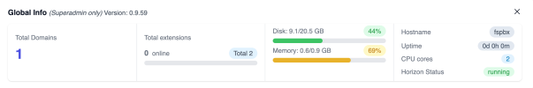

Interesting. After installation on Proxmox, you can reduce the RAM setting to 1GB with 1GB swap, and it runs just fine...
Thanks for confirming. I’d still suggest sticking with 4GB for now to make sure updates run smoothly. We’re releasing updates and new features almost daily, and FS PBX is in very active development. This pace will continue until every FusionPBX page is replaced—and until users stop requesting new features (the latter will probably never happen ).
